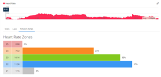

    Here are the HR details from the activity that didn't register any intense activity....
    Here are the details from the leisurely walk activity that registered 32 minutes of activity...
  • I only wear the device (Forerunner 35) during exercise, I don't wear it all the time, so I don't have a daily HR graph. Really appreciate your help with this.
    In that case it is clear - the reason is the high RHR before your run, exactly as I wrote previously. Put the watch on while you are deeply resting, before you go running, so that it has the chance to get your RHR.
