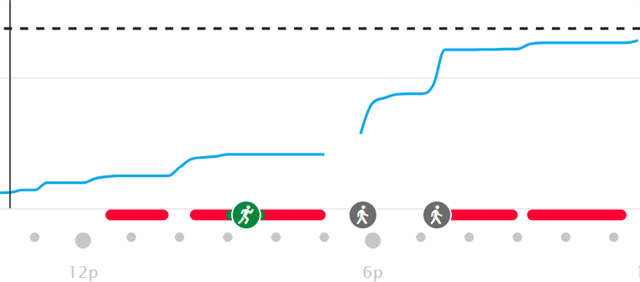

  • As you can see I did a 10k run around 4pm (green mark) and the steps count is flat.
    This is happening with all the runs since I bought the new Fenix6
  • Ain't you, by hazard, run on a treadmill, keeping your hands on the handlebars?
