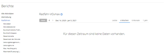

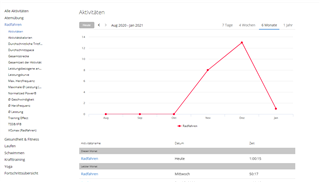

I rode now for over 20 times with my bike indoor and tracked all directly with Garmin. I can see all bike activities, but my Vo2Max is zero (0).
Why does it not calculate correctly?
THanks
Raik

    0 Former Member over 4 years ago in reply to trux
    Ok, sorry, here is one but I added the power data manually because my watch does not save them.
    connect.garmin.com/.../6059951036
    I also have some activities directly from Zwift created with all data.
    But both, Zwift and Garmin Activities with manuel power data does not show up in Vo2max.
    I read that the activities has also be recorded directly by garmin sensors or devices (I have cadence and speed sensor and Forerunner watch) is this correct?
  • my watch does not save them.
    In that case you cannot have the VO₂max estimate, since it is calculated by the watch, not by the app. It means even if Zwift has a powermeter, as long as it does not communicate the power directly to the watch, the VO₂max cannot be calculated.
  • Former Member
    Thats pretty sad, I have connected the cadence and speed sensor to the watch too.
    Thanks for your answers.
