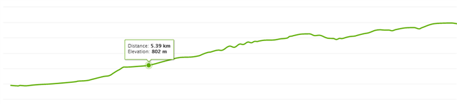

I'm inspecting a route that I created and first part of it looks like the image below:
This point is:
Distance: 5.39km
Elevation: 802m
Starting elevation: 474m
It's not the steepest route but it's pretty much uphill all the time. However the Average Gradient reported is negative:

At the aforementioned point, my Rise is 802 - 474 = 328m with the Run of 5390m. The gradient in decimal is 328 / 5390 = 0.0608, taking the arctangent (tan-1) of the ratio: α = arctan(0.0608) = 3.48°
I thought that maybe my starting elevation isn't taken into consideration but if that were true, the gradient would have been even higher and postive. Unless I'm calculating it incorrectly, in this case I would appreciate some explanation how to read the avg gradient metric.

  • OK, I see - it is what I suspected - you did not post the whole elevation profile, above. The Avg Gardient value on the right pane shows the average gradient of the remaining part of the course. So if you are with the mouse cursor at 802m and the end is at 577m, then the average gradient necessarily has to be negative.
  • Oh I see.. not what I expected though. I would rather see what is the gradient from the start to the point I'm highilghting. I'm presuming this is not configurable?
    Do you think thhis would be a useful feature. Basically to see the gradient so far not until the end. Since my courses are usually that shape, I would have to use thee selection tool many times to be able to see what the gradient was so far until the point I'm hovering over..
