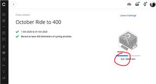

I go to Challengs and enter in any challenge (ex: October Ride to 400) and no value are show:
this is happening in Safari and Chrome, and in challenges like October rundown,

    Did that, and the error persists. I looked at the Inspect/Console and it gives me a bunch of errors

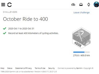

  • What version does it report in the footer of the page? mine reports 4.36.0.17, 20.21.2.
    Did yout try turning off plugins such as adblockers, that could attempt modifying the content of the page? Did you try it from another computer or a phone?
  • I got the exact same issue in all browsers I've tested. Tested with two computers and one phone. Turned off all plugins. Still the same error.
    It is just visual. The progress bar is correct. It is only the progress value that shows 0.0.
    It works in the app so I check the exact value there. You could also inspect the progress bar and get the percentage for the width of the blue part of the bar and calculate the value yourself Slight smile
  • Yes, challenges with distance units, like KM, show 0.
    Only steps challenges show correct number.

    My challenges still work fine. What version does your GC Web show?
