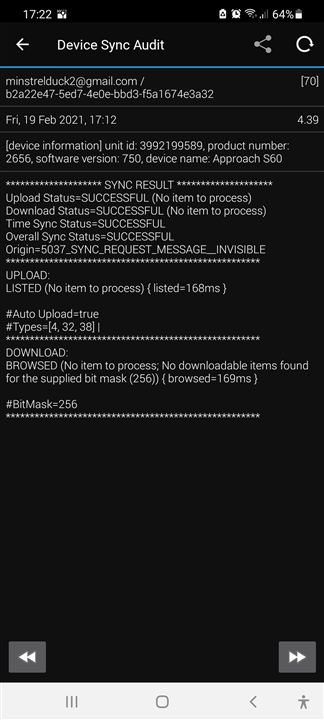

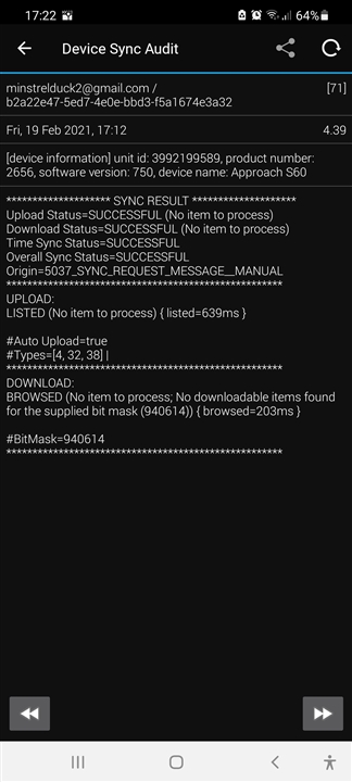

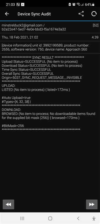

  • The audit is just for syncing on the phone. It does not tell anything about the importing in GC Web. After the import, did the number of steps change correctly on the dashbord of the web Connect?
  • The dashbord has always been correct its the reporting thats wrong
    I spoke about the dashboard on GC web, not on the mobile app. Both, the Steps on the web dashbord, and the mobile app Steps report, show steps synced to the server, while the Steps card on the My Day screen of the phone app shows just unsynced live data.
