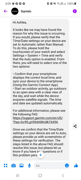

    Hello,
    The only thing that worked for me was resetting my watch.
