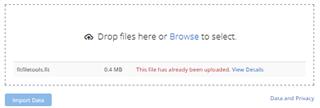

My run files has portions at 167kph. Is there a way to edit this?

first , stick with one tool to begin wtih as trux first suggested Fit File Tools's section remover

hi,
all spikes appeared during the first 13' where GPS fix was lost
your location is challenging for GPS fix
cleaned your fit file with help of Fit File Repair Tool
at 01'53" into the activity GPS stops recording to your fit file (no GPS fix)
at 12'32" speed distance switches to the watch for 4 seconds
at 12'48" into the activity GPS starts again recording to the fit file(GPS Fix)
before uploading, make sure you delete your activity from Garmin Connect Web
check this file 4920212855-fixed-gps.zip
