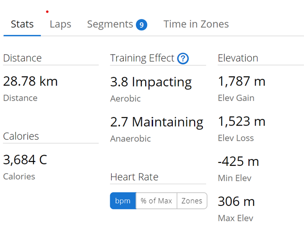

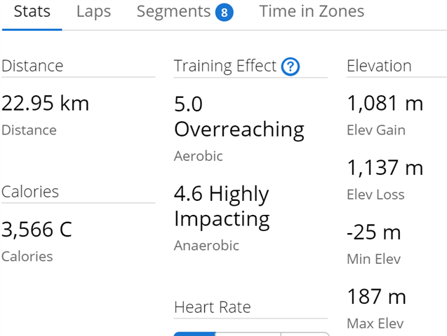

    Thank you i will try that. Whist you are being so helpful is there any way to sort out the calorie count? For example i go for a walk and it states that i have done over 3k in calories! Also i go on bike ride 23 km and it states 3.5k calories. yet i basically go on the same ride, except i go round one part twice so the overall length is 29km and it comes up with 3.6k in calories!
  • As for the Calories, it would be better to post your question in a separate thread, not to mix two unrelated topics here. Basically there are two parts in the Calories value = the RMR (Resting Metabolic Rate), and the Active Calories that are calculated from the difference between immediate HR and the average resting HR. We would need to see your RMR for the day (on the page Calories In/Out), the HR data of the Activity, and the average resting HR (in Reports) to tell you better where the problem could be. Try launching a new topic and posting the data there.
