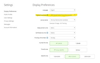

Whenever I complete a workout using my Garmin Instinct running firmware 5.10, the workout appears on the Garmin Connect web site with its time zone set to GMT -4 Atlantic Time (Canada & Central America), which is wrong. My time zone is GMT -5 Eastern Time (US & Canada) and I have Garmin Connect set to use the correct time zone in Settings -> Display Preferences on the web site.
My watch shows the correct time, the workouts show the correct time (both on my iPhone and on the web site), but the time zone is wrong on the web site. I can't seem to figure out what I'm doing wrong or what setting I need to look at, or if this is a bug with either the Instinct or the web site.
Before I contact support I wanted to see if anyone else has experienced this issue. I know I can edit the workout to change the time zone which is what I'm doing, but I wonder if there is a way to get it to assign the correct time zone from the start.
