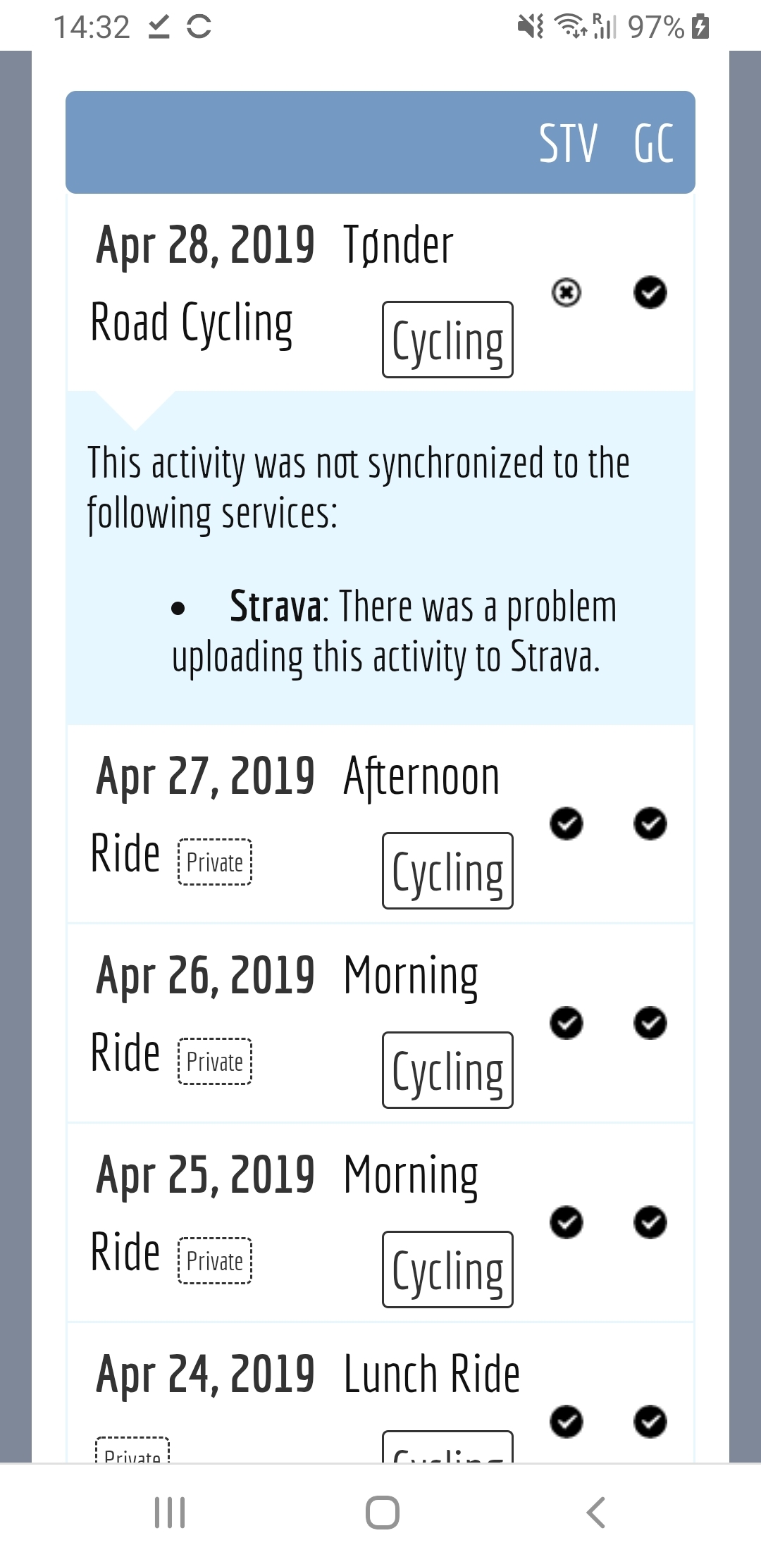

    Unfortunately everything I'm trying is failing, it's probably the best couple hours of riding I've done and I'm about to lose all hope.ciq.forums.garmin.com/.../1476495.jpg
  • Former Member
    0 Former Member
    Thanks a million @kiwimtnbkr!
