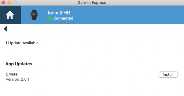

Hi,
After every sync, I receive an update. I believe issue is that for some reason, device is receiving updates for uninstalled watch faces. And when that happens, update is installed, and that face becomes installed and is automatically set to be default. Then I have to switch the watch face to one I want to use, and then to remove it again. And this keeps going on and on.
See attached screenshots and comments with each one.
Model: fenix 3 HR
Software Version: 4.90
Garmin Express Version: 6.8.0.0 (on macOS 10.14)
ciq.forums.garmin.com/.../1414036.png ciq.forums.garmin.com/.../1414037.png ciq.forums.garmin.com/.../1414038.png

    I was able to stop updates for uninstalled watch faces by removing all uninstalled watch faces from the list of watch faces. It seems that for as long as they are on your list, they receive updates.
