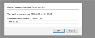

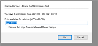

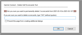

  • I cooked up a script you can use to delete scorecards within a certain date range (or all scorecards). You'll need a PC or Mac for this. (Although technically it would work on mobile too.)
    You can either run this as a one-off script (by pasting into the debug console), or you can install it as a "bookmarklet" which will run at the click of a button, any time you want. You may want to install the script if you foresee yourself using it more than once.
    (Note: the start and end dates are interpreted based on the timezone of the device you are using to access Garmin Connect.)
    (All of these instructions assume you are using Chrome, Firefox, Safari, or any other modern browser)
    Usage without Installation
    1) Get script from here:
    https://pastebin.com/JKbmiKwe
    Copy the script contents to your clipboard: Scroll to bottom of page, click on "RAW Paste Data" box, CTRL/CMD-A, CTRL/CMD-C
    2) Sign into Garmin Connect
    3) While still on the Garmin Connect tab, open debug console: F12 / CTRL-SHIFT-I / CMD-OPTION-I
    3) Paste script into debug console. A dialog will open in the Garmin Connect tab.
    4) To run it a 2nd time (for the same tab and session), type the following text in the console:
    gcDeleteGolf()
    Installation
    2) Open this page: https://caiorss.github.io/bookmarklet-maker/
    2a) Set title to "GC delete golf scores"
    2b) Paste script into "Code" box
    2c) Click "generate bookmarklet"
    2d) Drag blue bookmarklet to bookmarks bar. If the bookmarks bar isn't visible, press CTRL/CMD-SHIFT-B. If you don't have a bookmark bar or you're on mobile, select and copy the contents of Output box, bookmark any site at all, then paste what you just copied into the Address/Location/URL box. (In Firefox you can also right-click and select "Bookmark this link")
    Usage after Installation
    1) Sign into Garmin Connect
    2) Click on "GC delete golf scores" bookmark. A dialog will open in the current tab.
