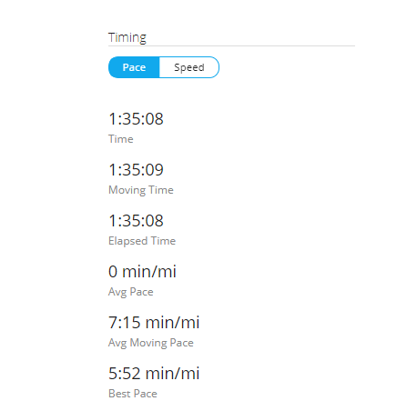

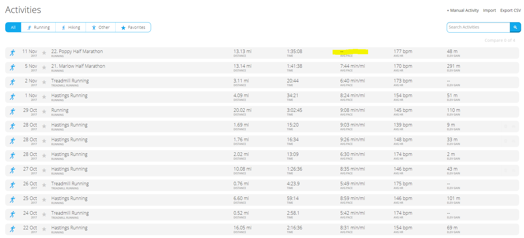

I've been using garmin connect for over 4 years but my last activity has an empty average pace value (see screenshot). I have never seen this before. The average moving pace value is correct.
The only thing I can think of that is different this time is that I edited the activity title using the garmin connect iphone app. Could this have corrupted the average pace value ? Or is it more likely to be an issue when the activity was synched ?

    This looks like it is an issue with Garmin Connect Iphone App.
    Further update - I edited the name of another activity and then saved it and the Average Page value got set to empty so I think this is an issue with the garmin connect iphone app. Is anybody else able to repeat this ? and is there a way of getting it set back ?

    The only way I could fix it was to delete the activity and re-import the .FIT file manually. I'll refrain from using the iphone app to edit it in future.

    Im having the same issue. But not on every run. I can get it to correct by just clicking edit, selecting one of the time fields and hitting the tab key. Should not have to do it though.
    I can reproduce it by doing what was mentioned by dansnellgrove
