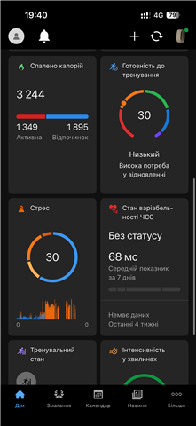

I’m experiencing an issue with Training Readiness on my Garmin CIRQA in the Garmin Connect app on iPhone.

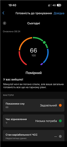

The Training Readiness value on the Home screen updates correctly throughout the day, but when I tap on it to open the detailed view, it still shows the morning value and does not refresh.
For example, today:
  • Home screen: Training Readiness 30 (Low), showing a high recovery need after my workout.
  • Detailed screen: Training Readiness 66 (Moderate), last updated at 08:24 AM.

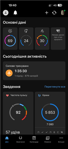

  • I completed a strength training session lasting 1 hour and 35 minutes, which was recorded successfully.
  • Even after refreshing the app by pulling down, the detailed Training Readiness screen still shows the morning result.

I’ve attached screenshots showing the difference between the Home screen and the detailed view.

  • I only have the CIRQA, no other Garmin devices. Sleep and Body Battery seem to work fine for me. The only issue is with Training Readiness — the Home screen shows the updated value, but the detailed view is still stuck on the morning reading.
  • Training Readiness in Garmin Connect only updates in the morning and after each activitiy. It is updated continuously on the devices and that is the value you see in the home page which shows "real-time" values from the device. When you click the card you see the value in Garmin Connect.
  • Thanks for the explanation! However, yesterday my Training Readiness did not update in the detailed view even after a recorded strength workout lasting 1 hour and 35 minutes.
    The Home screen showed 30 (Low), while the detailed view remained at 66 (Moderate), last updated at 08:24 AM.
    I tried refreshing Garmin Connect, but the detailed value stayed the same.
    If Training Readiness is supposed to update in Garmin Connect after each recorded activity, shouldn't the detailed view have updated after my workout? Could this be a bug specific to CIRQA?
  • It should update after each activity. See if it happens again. "One time is no time"
