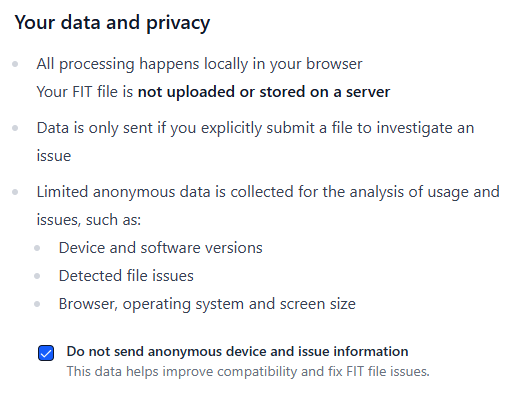

  • I’ll inspect the export locally rather than upload it to a third-party site.
    You can still do it https://www.fitfileviewer.com/ - it does run in JavaScript locally on your computer. This is the Privacy Policy of the website, and if you do not trust it, you can review the JS code:
  • You're right—thanks for clarifying. I confirmed that Fit File Viewer processes FIT files locally in the browser. That resolves my privacy concern, but it does not change the discrepancy: the daily series tops out at 162 bpm, the activity at 169 bpm, while Connect reports 185/193. The unresolved question is still which sensor and timestamp produced those values.
