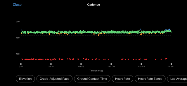

Cadence cuts in half when using metronome
 When using the metronome feature with vibration, the cadence reading occasionally drops to half the actual value, which skews the data in the end.
  • I do not experience the same, but in your place I would just use the acoustic beep in such case. Perhaps attaching the wrist band a bit tighter, or running on a harder surface (or using different shoes) could help too, but apparently the vibration adds a too high noise to the accelerometer. Of course, you could also contact the Support, and report it to them, but I do not quite believe they would help you much.
