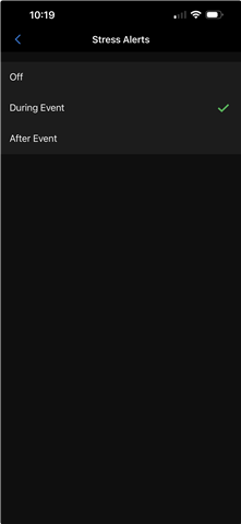

- Stress alerts are set to During Event in the Connect app
- Stress alerts are set to During Event in the Venu 4 watch

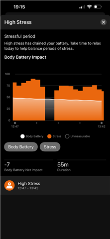

- I experience periods of high stress (for hours) which shows in my stress graphs

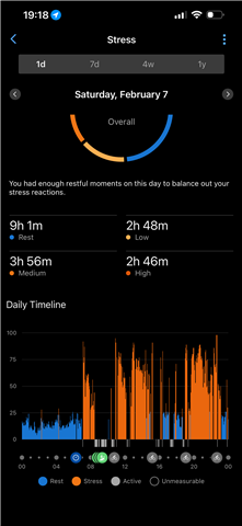

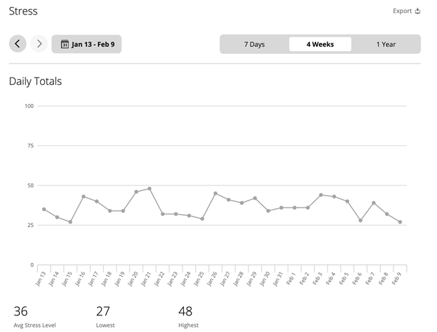

    Perhaps, if you post a screenshot of your 4w Stress Report at https://connect.garmin.com/app/report/63/wellness/last_four_weeks (showing the averages), and the Stress chart for the day that you believe should trigger the alert, we could see some clues why the alert does not happen.
  • Thanks, I would for example have expected an alert February 7th, where high stress was also listed as one of the factors contributing to a low body battery.
  • Yes, it indeed looks like the alert should have happened. I recommend posting on the Venu 4 forum, to see whether other owners of the same model have similar experience. Here, you are on the forum for the Connect app, and it is uncertain whether any Venu 4 owner will see your post.
    If other users do receive the Relax Reminders, then I'd first try resetting the watch to factory defaults, and wait three weeks (to establish a reliable stress baseline). If it does not help, then I'd request a replacement watch from Garmin (assuming your watch is still under warranty).
