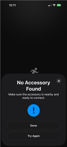

Hello everyone. Since the day I updated to iOS 26, my phone and my watch have not been able to connect to each other via Garmin Connect. I’ve tried everything that has been suggested on the forum, but I haven’t been able to solve the issue.
Should I be waiting for an update from Garmin or from Apple regarding this problem? I’m not even sure if I’m the only one experiencing it.
Thanks in advance to anyone who can help.
