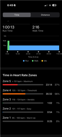

I’m using a Fenix 6S pro Solar. My Max HR is 169. I’m female 64.
I use a Fenix 6S Pro Solar to record indoor runs and biking. Usually the training effect is accurate. However, in the last week I have had weirdly low training effects.
I ran 60 minutes (endurance run) where my HR was mainly in Zone 4 (56%) with 37% at the low end of the Zone 5. I got a training effect of 0.2 Aerobic (0 Anaerobic) and a Training load of 2.
Usually I get reasonable Training loads and effects. Can anyone explain what happened?
