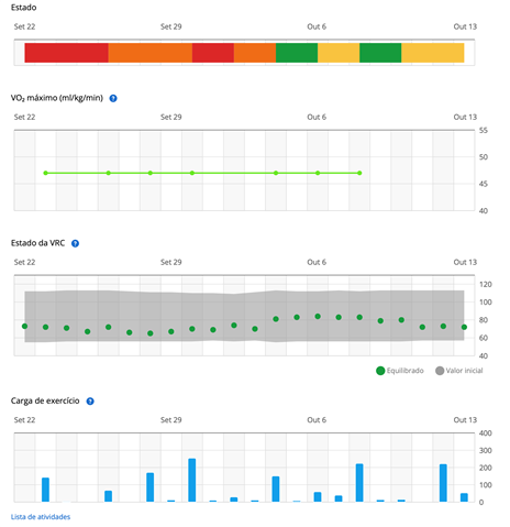

there is some other problem that can cause this? In the training status every data is assumed unless the VO2 MAX

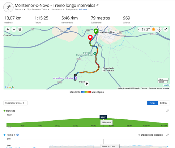

here you have a exemple of a run on Sunday,
And you can see that vo2 Max is not assumed:
