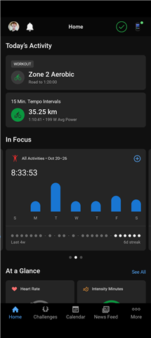

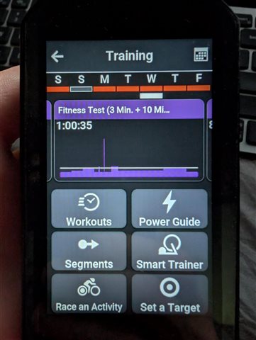

Any help on this would be great. Im following one of the Garmin Connect New adaptive training plans and carrying this out via an edge 1050 and kickr. I’m having. I’m selecting the workout from the garmin coach section on the training tab or from the Home Screen. The workout then syncs to Garmin Connect but doesn’t mark as completed.
I did read on here that if I edit the activity and change event from uncategorised to Training this would sort the issue. But doesn’t seem to be working.
Have included a picture below . Thanks for any help with this
  • The picture doesn't tell if the activity has been identified as the workout. The workouts will stay even if you complete them. Not sure why but I've recently seen questions about that the workouts are staying for the day even if you complete them. Look in the training plan to see if it was identified in the plan or not.

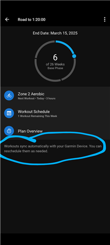

    I’m not sure what is happening so I just had a look at the plan as you suggested and it just has yesterday as a rest day which suggests that it doesn’t know I completed the workout even though I did. Then I kinda worry that it’s not taking into account the training that I’m doing.  Maybe I have got this all wrong as I’m new to Garmin training plans.
    as you can see below the Thursday was the day I did the workout that didn’t log as complete and now it’s just a rest day. The only rest day I actually have booked in was the Wednesday lol

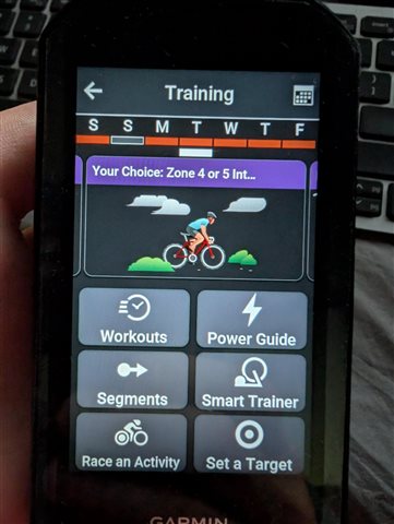

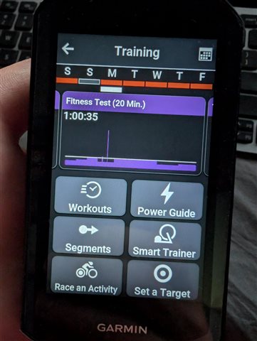

  • Today my 1050 out of nowhere changed all the workouts under Training... Even the ones I already did. Connect app is still showing the right ones for the base phase.

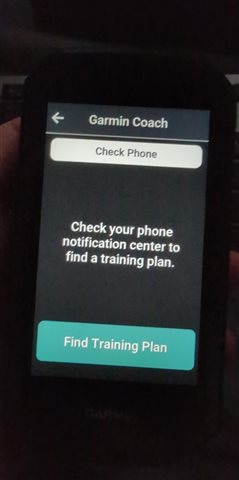

    Even though I have a training plan, 1050 under Garmin Coach says: "Connect your phone, and open the Garmin Connect app.". Nothing changes after doing that.
    I am going to return this expensive piece of ***.
  • I seem to have been able to get mine to match off. I sync my phone to the garmin. Then go into training on the edge 1050. Rather than go into the garmin coach. I just go into workouts ask select that workout and it matches on garmin connect.
    with your issue I’m not sure what has happened. I have workouts change but only really when I have did other training outside the plan.  Like weights or outside cycling.
    I haven’t had anything change that I have already done.
    I’m not sure if the issue is with the Garmin Edge 1050 or Garmin Connect but for me it’s seems to be working ok for now.

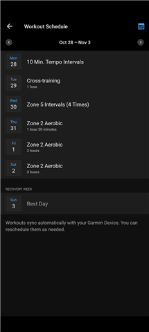

    I sync 1050 with Garmin Connect, but the most important part doesn't sync..
  • I can use only training, because Garmin coach doesn't work on 1050... I get the popup in my Pixel 8 Pro, pressing which brings me to the existing training plan. As you can see in previous post it doesn't sync, even though Connect clearly says it should.
    I really don't get how this can be happening with latest Android and Garmin's top cycling device. :(
