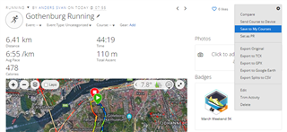

    If you mean the Elevation Gain of a section of a navigation course, then you can see it in Garmin Connect Web » Courses: on the elevation profile graph, simply select the section of interest, and move the mouse cursor over the section. A popup window will show you the details of the selected section, including the accumulated Total Ascent (Elevation Gain), and Total Descent.
  • Nice!
    To do that with a logged activity you can view the activity in Garmin Connect Web and click "Save to My Courses". The course will open up and you can select the elevation profile. You don't have to save the course. This is just a method to quickly view the accumulated ascent.
  • Yes, either that, or you could also use the function Trim Activity, and trim it to the section of interest. Since the trimming is reversible, you can repeat it as many times as needed, with different selections. For a single selection it may be quicker, but otherwise using the option Save as Course, is usually more comfortable
