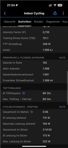

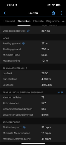

I saw that my active calories are not correct on last Saturday. I had two activities with 577 and 1399, but overall it's shown only 1626.
Why is the calculation that off?

Did you use two different devices for the activities? If so, then the data probably did not exchange between the devices (and to Garmin Connect) correctly or entirely. Always sync both devices before and after each activity. Often you may even need to repeat the syncing cycle twice (syncing the watch - edge - watch - edge). If it does not help, report the issue to the Support.
Yes indeed I used to devices. Usually I'm doing it like you described but I think this Saturday I didn't. Let me try this again on Saturday because I have the same amount of training.
