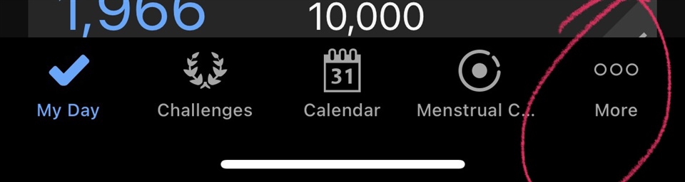

This is the bottom menu as of now, the fourth icon from left to right is the one for Pregnancy (Embarazo) tracking. App version is 4.72.1 and I have a Forerunner 935.

  • Thank you for your message. I'm sorry that you went through the same loss.
    As of today, I have tracked 5 cycles after the miscarriage, and the Pregnancy icon is starting to bother me. I'll try deleting the app and re-installing it. Thanks for the suggestion Slight smile

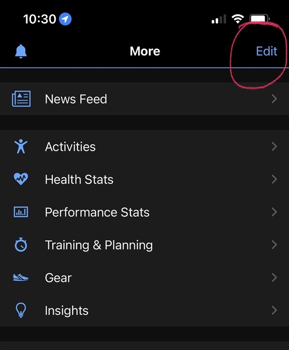

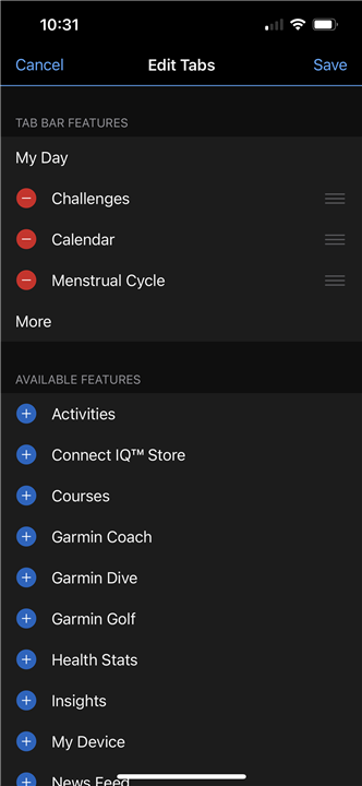

    You might also want to check the settings.  Maybe you can manually move it out of the menu.
    I re-installed the app as per the suggestion from  and the Pregnancy icon disappeared. In addition, I've used your instructions on how to configure the bottom menu. Thanks to that, now I have the information I want in the bottom menu.

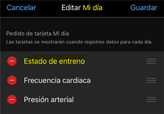

    The remaining thing is to bring back the Training Status widget into My Day. Do you know how to achieve this? I've already tried edditing MyDay (Mi Dia) to make sure Training Status (Estado de entreno) is included. But despite the fact that it is, it is still not listed.

  • I've already tried edditing MyDay (Mi Dia) to make sure Training Status (Estado de entreno) is included. But despite the fact that it is, it is still not listed.
    This might be the issue: Missing Data From the My Day Page in the Garmin Connect App | Garmin Customer Support
    The My Day page will not display cards if there is no data for that metric from that day or if you do not have a compatible device. For example, if you have not recorded any steps the Steps card will not appear. Also, if your Training Status currently shows "No Status" then the Training Status card will not appear either.
