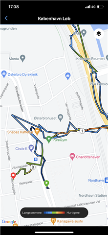

Wrong trace of run
Wrong trace of run
Hard to tell without seeing the data. Share a link to the activity, and we may perhaps try to help.
Did you get the GPS lock sign before starting the run?
Possible reasons are an expired EPO/CPE file (ephemeris data), insufficient GPS signal (high-rise buildings, walls, terrain, vegetation, ...), hardware failure, a firmware update gone wrong, ...
I recommend syncing and then soft-resetting the watch (holding the light button till the watch shuts down - no data will be lost), connecting the watch over the USB cable to a computer with Garmin Express, and checking for updates. Then make another run, and do not start before getting the GPS lock.

However, the instructions in my previous post could help. Try them first before the next run, and then let us know the result.
