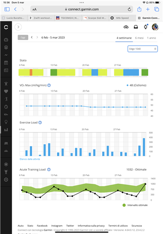

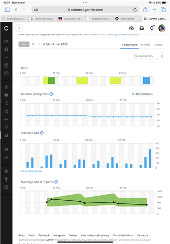

Done an activity on Garmin Edge 1040, undate Garming Connect and the Forerunner Training Status is not updated correctly compared to wath I see in the App and Web.
Since the last update was supposed to fix the 7 days load problem.
I attached 2 screenshot of web Connect
  • Those two devices use different training status versions so it is likely that the training status will be different. Edge 1040 use the new training status 2.0.
    Edge 1040 use Acute training load and 945 use 7 day training load. The VO2 max is the same for both. The load graph looks identical so I believe it is the different training status versions that makes the status be different.
