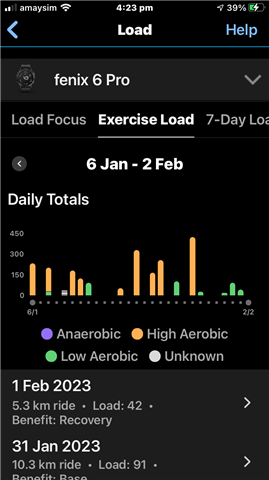

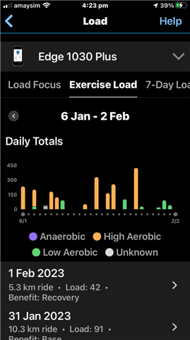

Fenix 6 pro and 1030 plus. I wear the Fenix most of the time. 1030 plus for bike rides with Fenix broadcasting HR. Not just different loads, but different advice. I sync both before activities, both have physio true up enabled, both firmwares are up to date. Same person, same dates, same activities. Both using 'acute load". Very different results, very different advice. Very different graphs. Why?
  • The advices will be different because you got different values. So the question is why the values are different.
    I believe you might have failed to sync the values between the devices some time or several times. Check the exercise load pages and compare between the devices. They should look exactly the same if you synced them before every activity.
  • I take your point. But both devices are synced before activities, and the load pages are identical. Still different totals, leading to different advice. Same on Garmin connect web, two very different training loads. Here's IOS loads

  • No that doesn't change when I switch tabs. If I flip between fenix and 1030 plus  both show acute load as in my 1st post. When I switch to the "excercise load" tab in both, both read 7 day load. The screens are the same. Total remains different. Very odd. I agree the manuals show the extra training status level on the fenix. But that is just a label applied to a total, it shouldn't affect the totals calculated?
