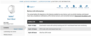

    I’ve yet to get the 25 days claimed by Garmin. I don’t use the GPS much and will get about 18 days.
    18 days with occasional use of GPS sounds very fair to me. Instinct specifications tell "Up to 14 days" in Smartwatch mode (no GPS used at all)
