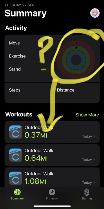

  • No it definitely was suggested that it was going to populate Connect with your previous fitness data from the iPhone. Either way though I did give it permission and it didn’t work Face palm tone2 thanks for your response.
    I’ve just realised that it looks like the Apple fitness hasn’t been receiving any data and is empty on my first full day with the Garmin. Looks like you were right - the Garmin’s data isn’t working back to the iPhone either.
  • Thanks for that info. In settings though it says it reads & writes all the data!! Wtf??! See images
  • Apple fitness seems to have the data but not showing it in the rings?
  • Right underneath where it says "Data from "Connect"" is where it will show what it is trying/able to read, as it is managed separately from write.  Everything you have shown there is under the "write" section.  So Garmin can tell Apple, but won't listen.
  • It's not showing it in the rings because Garmin ignores the API standard.  They don't time stamp anything the way they are supposed to so, even though you went for a walk, Garmin tells apple you did it in zero seconds.    Connect is also well known to write double data for calories, and then sometimes either remove them later or apparently add even more the next day.  Basically the Garmin integration into HealthKit is a mess.  They know it.  They've known it for years, they said on the forum they don't plan to fix it, but yet they have no problem advertising it......
