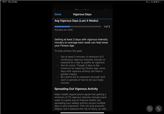

Do you have any source to that information? 5 minutes sounds like very few minutes.

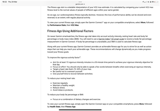

The original method for the Fitness Age used the VO₂max only. The new method using vigorous days, BMI, and RHR, seems to be still in the finetuning process, and the description changes over time. And the algorithm likely too. The earlier description of the Fitness Age referred both to 5 continuous vigorous minutes, as well as 15 vigorous minutes in a 30-minute time period, but recently the 5 min specification disappeared from the Fitness Age help screens in Garmin Connect, hence the exact conditions are uncertain.
Though, the page about the Fitness Age on the Health Science website of Garmin, still mentions the 15 minutes in a 30 min period, so perhaps it is the right method currently used.
You can see both those descriptions for example in the thread Achievable Fitness Age
