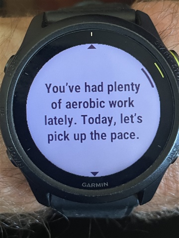

    So my Garmin suggested workout today was this.
    So I do the workout and actually do the 10sec intervals higher than the suggested 530W. I average 600W. The Workout summary is as follows:-
    And it barely moves the needle  on the Load Focus.
    Despite focusing on high power anaerobic efforts this last week, it's showing me way below the optimum range.  Looks like I'd have to do insane amounts of Anaerobic training to fall within the optimum range.
