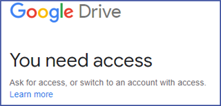

the manual upload was not successful. The system does not accept the file. Here is the link to the file on google drive:
https://drive.google.com/file/d/1rIqKjpAXWKrQ60kpYr3L-PN9Z2S7iU_S/view?usp=sharing
thanks
Wojciech
Please make your link public.
Hope it works now. Thanks. Wojciech
Hope it works now
Yes. Thank you.
