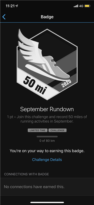

I have noticed that running activities and walking activities are not counted towards “September rundown challenge” and “September 16 hours of walking challenge” for me.
Last 2 weeks I was on “August rundown challenge” and it worked perfectly...
Anybody else experiences the same issue?
Thx!

    As far as I am aware, nothing has changed since last week... No updates etc... I am sending screenshots and making the activities public.

  • Former Member
    0 Former Member in reply to e7andy
    @e7andy Thx for help... for some reason it started counting right after i made the activities public.
  • Great! I didn't see anything wrong with them so that was really good since I didn't have any ideas at all how to fix it :-)
    Edit:
    Maybe the change in visibility of the activities counted as an edit and the activities were evaluated once again. The tip next time when something isn't working with the challenges and badges could be that you do an edit of the activity.
