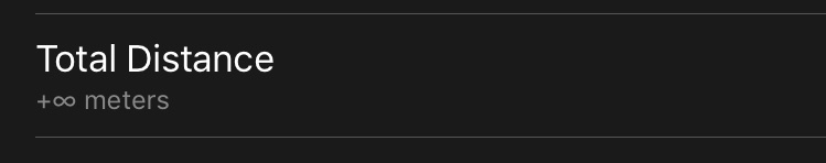

After my last software update on my Garmin 3 HR (about 3 weeks ago), I have since been unable to edit my lap swimming activity on the Garmin Connect app (which has been also updated 2 days ago (version 4.16).
Every time I change the number of the pool lenghts actually swum on the "edit activity" tab, I get "total distance=?" (please see photo attached)..

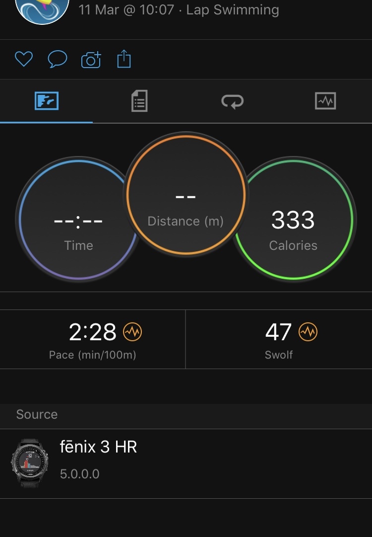

..and when I save the data to then return to the actual "Lap Swimming" activity tab and get the summary, I have no total results in both time and distance fields (please see photo attached).
I was before able to change the number of the pool lenghts without any problems and get the new total distance swum but then, about 3 weeks ago, I got a software update on my Garmin 3HR and since then I am left with this inconvenience.. In the past days I have updated again the software on my watch but without solving the issue.

ciq.forums.garmin.com/.../1463522.jpg ciq.forums.garmin.com/.../1463523.jpg
