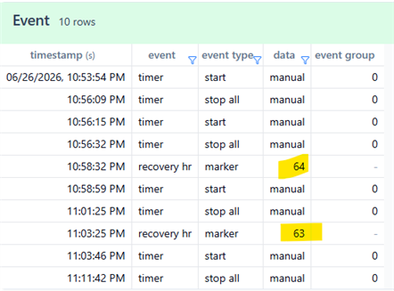

    That's exactly what  complained about - when you measure the Recovery HR after the effort, and then continue with the cool down, you do not get the Recovery HR in the stats, despite that it is saved in the activity FIT file. The FIT file contains even multiple records, if you measure the Recovery HR after several high effort intervals, but Connect does not show any of them, unless it was measured after the end of the activity.
    So currently the only possibility is immediately saving the activity after the effort, and recording the cooldown separately.

  • Garmin’s logic is:
    If you Save immediately after the 2‑minute recovery HR countdown
    • Writes the Recovery HR result
    • FIT file contains the official event
    • Connect displays it
    If you Resume after the recovery HR countdown
    • Garmin discards the Recovery HR result
    • FIT file contains only the marker
    • Connect shows nothing
    I used Fit File Repair Tool and Fit File Viewer to confirm.
