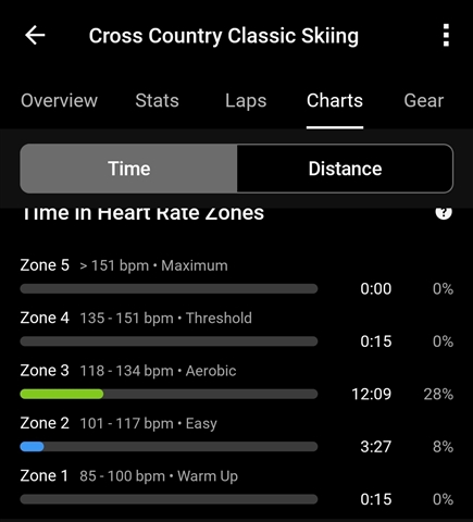

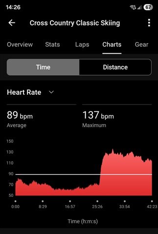

As can be seen graphic #2 (from chest strap, I suppose) , I spent only one minute in Zone 1, whereas graph #1 (matching watch audio alerts) shows me 18 minutes in Zone 1.
Why isn't the strap data used to plot the heart rate graphic?

No, image #1 shows that you've spent around 16 below Zone 1 and only around 2 min in Z1. Your Z1 starts at 85 bpm, and the graph during the first ~16 min shows HR of some 70 bpm most of the time.
My real heart rate was always above 100bpm, as this is x-country skiing. My Garmin 965 somehow kept wrong readings for 16 minutes!!! But why is the real bpm not showing in chart #1 as I was wearing my chest strap?
Hard to tell, but I see basically three possibilities, either your HR was not as high as you think, or the strap was not connected, or the electrodes were dry, hence not broadcasting reliable data, and the watch switched to the internal sensor (which due to the cold weather, and the cold induced peripheral vasoconstriction could not record accurate HR either). You could perhaps see it better when you export the activity FIT file, and open it with https://www.fitfileviewer.com/, where you can compare the wrist HR, external HRM, and the resulting HR curves. That will show you which of the sources were used.
Hi Trux, here are my stats again. It seems the HRM strap got the right info, but why is it the wrong watch info that gets displayed on the heart rate graph?
These charts are from today and the same problem from last week occurred.
Look at my previous reply - I listed there the possible reasons, and also the way you can see more clues with the fitfileviewer
Hi « Trux », thanks for your help. My problem was that I was not wearing the HRM properly. I was putting the « Garmin device » right over my heart and thus had no connector on my left chest! Because of the cold, I was not sweating enough but somehow the strap could function after 15-20 minutes, as sweat build up. I also never wet my connectors prior to skiing. But I am reassured now that the heart rate shown on my watch comes from the strap, which was my concern all along. Thus the audio heart rate alerts I get while x-country skiing or any other activity, when I wear my HRM strap, are effectively coming from the strap.
