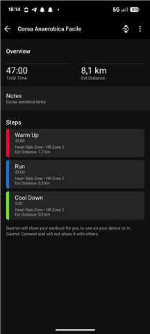

**Workout 1 - Easy Aerobic Run:**
- Duration: 47 minutes
- All in HR Zone 2
- Estimated distance: 8.1 km

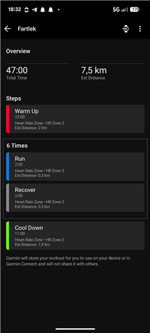

**Workout 2 - Fartlek:**
- Duration: 47 minutes total
- 12 min warmup (Zone 2)
- 6x [2 min run (Zone 3) + 2 min recovery (Zone 2)]
- 11 min cooldown (Zone 2)
- Estimated distance: 7.5 km

  • Unfortunately, the estimation algorithm is rather rudimentary, and not really anywhere close to be smart (or accurate). As long as you do not specify any target pace in the workout step, your average running pace is used for the estimation (regardless of the HR target). It seems to be 6 min/km or perhaps somewhere slightly below it in your case. The difference in the total distance comes from the rounding errors - for example at the 6 series of 2 min run + 2 min recovery the pace of 6 min/km gives 0.3 km when rounded, although it is in fact 0.33333333 km, hence 4 km (6×2× 1/3) in total (perhaps even slightly more if the avg. running pace is faster than 6 min/km), instead of the 3.6 km used.
