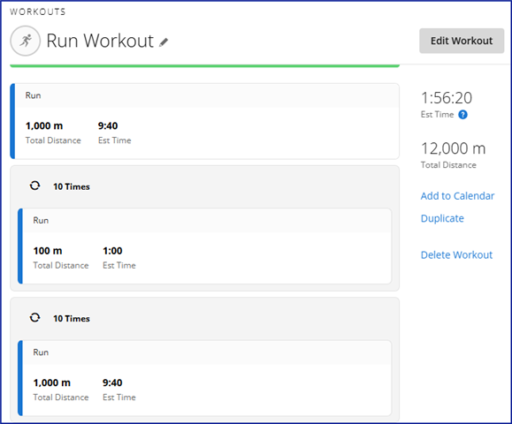

As a workaround, try using Garmin Connect Web.
I realize that. I was able to replicate the same problem in the app. But it works in Garmin Connect Web - connect.garmin.com/.../workouts

example:
What happens is if i have an activity that has e.g. 1000m + 10x100m +10x 1000m instead of adding them up 1000+ 10x100 + 10x1000 = 12000meters
it adds them up like 1000 + 10x(100+10x1000) and this adds up to 1000+ 101000 = 102km.
it is annoying and i need to do the math all the time.

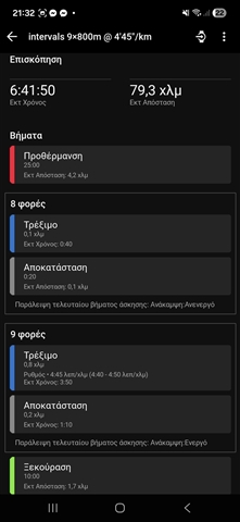

It is a bug in the app which was introduced like 6-7 weeks ago. The wrong totals are also migrated to the watch when you send it there.
Sorry if it is all Greek to you but you can see the numbers in the screenshot.
I definitely wouldnt do 79km on an idle tuesday.
