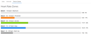

Used a Instinct Crossover to capture this mornings on the water rowing session.
Whilst the Intensity Minutes always worked perfectly for me, since the last firmware update on my watch it seems to be off (see picture).
Zones of this activity:
However i try to twist it, nothing matches the Intensity Minutes calculation.
Please fix.
Thanks!

    Thanks for the feedback, but this is not correct. If you look at the time of the activity, it tracked 52min, nearly 36min of those moving. I'd bet that for more than 50min my HR was above my resting HR of 52bpm. You can check this by looking at the HR zone diagram if you want to be sure. All captured zones are above my resting HR. The watch (or online app which received the data from the watch) only tracked 17+7=24min in total. Something's definitely off here. And I never had these issues before, this is new.
    Cheers.

    My general rule is that you get moderate intensity minutes for zone 3 and vigorous for zone 4. It isn't that simple here since it uses resting HR but it seems to be close enough. In some watches you can define the zones.
    So, you had 17 minutes in zone 3 and got 17 moderate minutes and you had 9 minutes in zone 4 and got 7 vigorous minutes.
    To me that is close enough.
