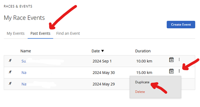

  • I do not see the option to duplicate a past event.
    I have it here:

  • When I review the JSON data of the events using browser's DevTools, I see two differences between those that can be duplicated, and those that cannot. I can duplicate past event where the property "eventOrganizer" is set to true, and they have also "eventPrivacy" set to "PRIVATE" (though I do not know whether the later plays a role or not).
    You can try opening the page in DevTools of your browser, and on the Network tab, checking the stream "events", and then verifying how those values look like at your events.
