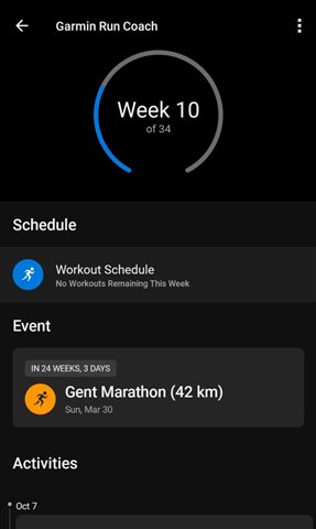

I have started a run coach plan some weeks ago for a marathon. In the past I was able to see the upcoming workouts in my calendar, however now I am only able to do that when I go to Run -> Training -> Workouts -> Daily suggestions (marathon) on the watch itself. Next to that, what is the use of the Garmin Coach since the last update?
So to summarize:
1. Am I able to see my upcoming workouts somewhere in the Connect app instead of only on the watch?
2. Does the Garmin Coach widget (both on the watch on in the app) still do something? When I go to it on the watch it forwards me to the app, and when I check it on the app it doesn't show anything in my calendar. (it also suggests to "find a plan", although I'm already in week 10 of my plan)
