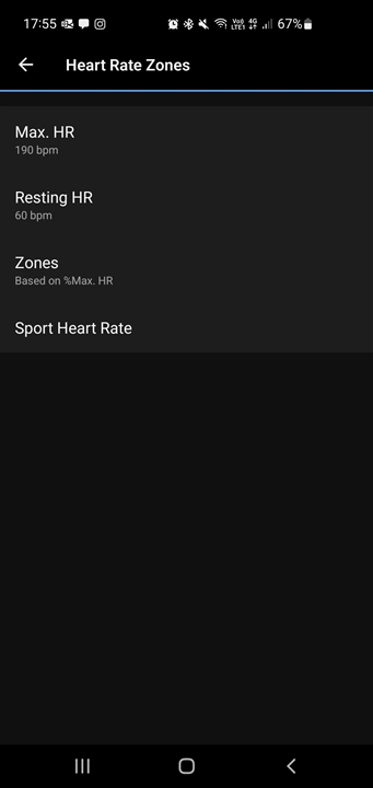

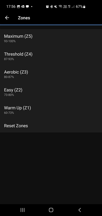

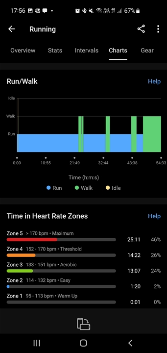

Im using a venu 2 sq music and experiencing an issue whereby my custom heart rate zones are not showing in my activities correctly. Instead, only factory HR zones are showing. I've followed some guidance online and everything is synced up so should be fine. The custom zones are even showing in my settings in the watch.
I'm hoping that is resolvable, otherwise I don't understand the point in being able to customise your zones.

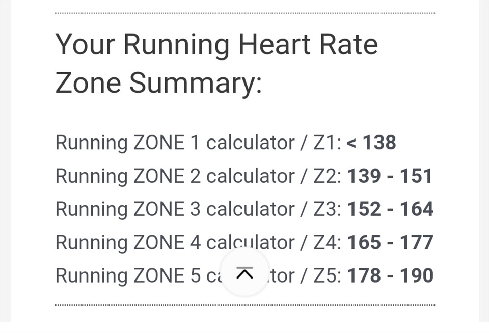

For reference, the new zones should roughly show as:

  • Was the activity done before or after the change of the HR Zone? The change has no effect on previous activities.

  • ... also, when you tap the last item on the HR Zones screen "Sport Heart Rate", verify that the Running HRZ table is either not defined at all, or that it is set identically, if it is there already.

  • Thanks for the quick response. The activity was done after the HR zones were changed. I even checked my watch before hand and could see they were set correctly.
    Thanks for the pointer on the sport heart rate zone. I've just set this up for running now. Could that be cause? I just assumed your overall HR zone would apply to all sports unless overridden at Sport Heart Rate Level.
  • Thanks for the zone 2 running tip. That's the exact reason why I'm so keen for this to work correctly :)
  • I've just set this up for running now. Could that be cause?
    If a running HRZ table already existed then yes. You can test it quickly and easily by starting a dummy running activity for a few seconds (without leaving the chair), saving it, and then reviewing the stats of the activity. No need to wait for the next run.
    Only if no table for the concerned sport existed. If it already exists, then the general table will not override it. It would not make much sense.
  • Brilliant, that's worked a treat. Thanks for you help Slight smile
