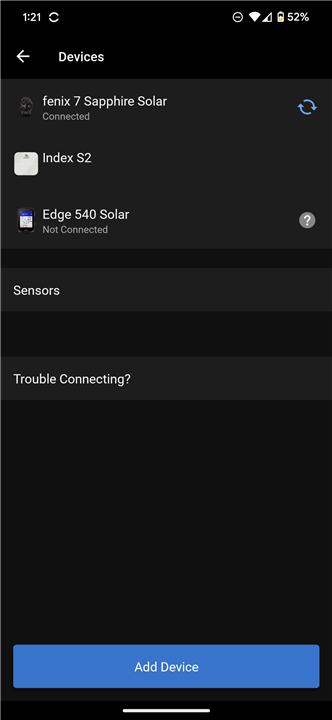

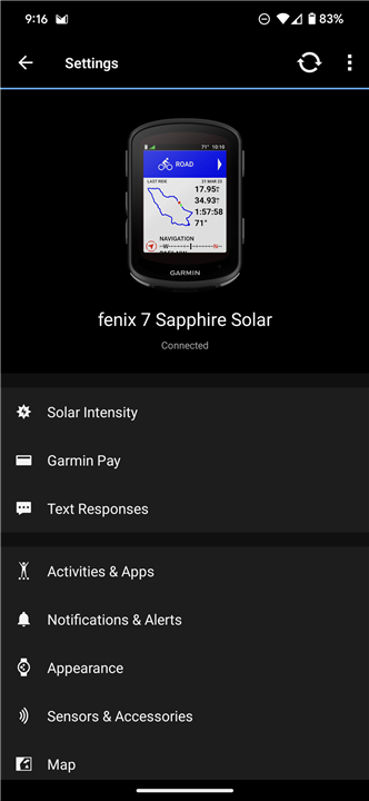

is there a way to have the Connect App under Android refresh the device icons? After adding my Garmin Edge 540 Solar, the icon for my Fenix 7 Sapphire Solar was replaced by this incorrect icon.
If further detail is needed, please reach out.

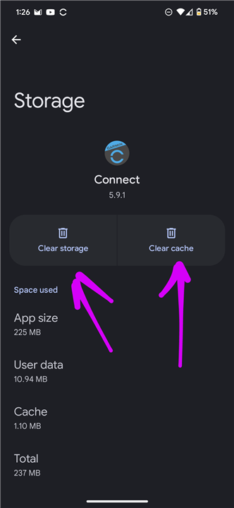

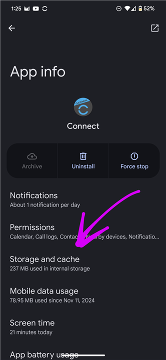

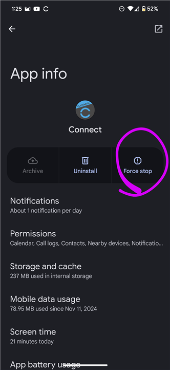

Was able to resolve this just now ...
If you have an Android device then the following might resolve things for you as it did for me:
After re-opening the App and signing in, all devices were still associated with my account and icons were fixed.
