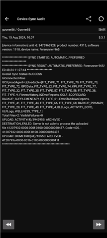

  • Firstly, thanks for the quick reply.  This would be the first sync.
    Destination failed - server is not able to process the uploaded file... So does that mean I need a computer?
  • Destination failed - server is not able to process the uploaded file... So does that mean I need a computer?
    The return code 400, could also mean a restricted HTTP access to the upload server - for example due to your IP address being blocked by Cloud Flare (security gateway used by Garmin). You could try changing the Internet connection to an alternative network - i.e. using a local Wi-Fi access point instead of mobile data, or vice versa, or an public, or neighbor's AP. You can also try rebooting the phone.
    If not helping, then either use the PC for importing the file manually, or reach out to the Product Support through their website at https://support.garmin.com.
