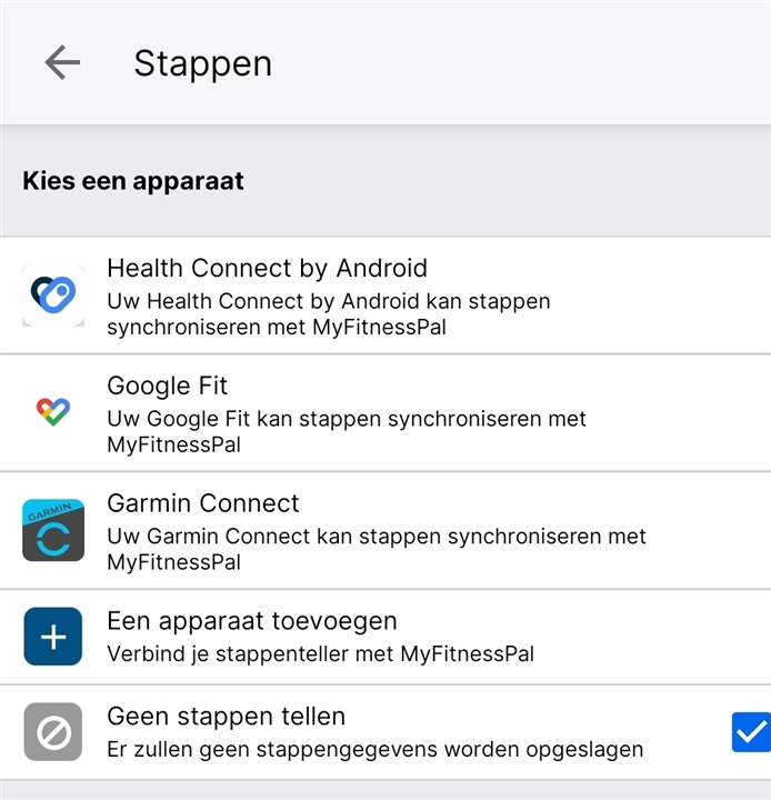

  • I meant MFT is not tracking steps.
    When you click on the steps, you can choose to use steps from Google, Garmin or don't count them at all. I choose that last option.
    Garmin does count the steps, but MFT doesn't use them as input.
    Either way, I'll be testing the 'negative' option to rule everything out.
