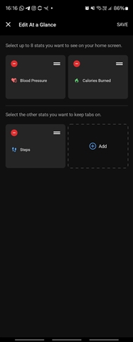

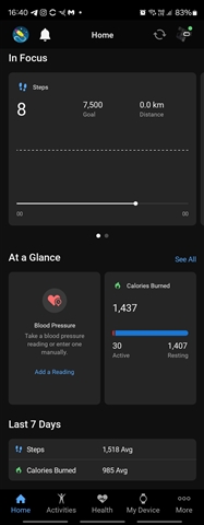

    Either among the "Glances" (Edit them and add the HR glance, if not visible), or on the current day table at the bottom (above the 7 days table) - when you tap the line with the HR, it opens the detailed HR screen. Or you can access that screen through the menu - tap ... More bottom right » Health Stats » Heart Rate

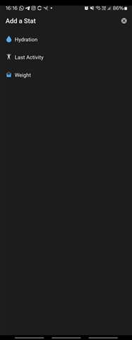

  •     I've attached some screenshots to show that I don't believe I have the options you are talking about. But again, if I'm being blind, let me know.
  • It looks like the HR is not available with this version, when you have just the HRM-Pro strap standalone, and no watch associated with the app. I can only suggest the following solutions:
