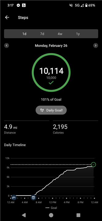

I have a Garmin Lily. It records an accurate number of steps through out the day. However the distance vary even though the steps do not.
Example: One day 10,114 steps = 4.9 miles.  Then the next day 10,112 steps = 5.7 miles.
This happens regularly.  I have not noticed a pattern.  This is just walking around a classroom while teaching.  Not during runs or hiking.

  • Normally, timed outdoor activities, where you use GPS, may result to variable distance results, because the stride is not constant. The combination of GPS and accelerometer (especially the cadence) is used during the outdoor activities to get the true distance. However, I can see on your screenshots that there were no such activities on those two days.
    Normally, on the Daily Timeline only the Custom Stride Length is used to calculate the distance (see The Step Distance Recorded on My Garmin Watch Is Wrong | Garmin Support) when there is no outdoor activity. I do not know whether Garmin changed the algorithm, and they now use the cadence to adjust the distance at indoor walking too, but since both days show rather similar curves (so probably also similar cadence), it is surprising the difference of the distance is rather important. Definitely contact the Support, and please report back if they answer - it may help others too.
