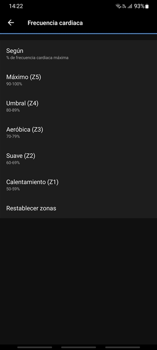

Please, can someone help me? topic: manual change of heart rate zones. I have changed them both in the Garmin connect app and in the fenix 7x in general and in type of activity and it still does not show me the new zones during the specific training or in the activity once it is finished and downloaded in the app. Additionally, Garmin's help options are not working to communicate with someone about this question. thank you so much!
  • Please note that there are up to four different HR Zone tables - the general one, and the separate tables for Running, Cycling, and for  Swimming. Make sure you are changing the relevant one. Also note that if you base the table on the percentage of the Max HR, LTHR, or RHR, then the absolute values will change if the base value changes. Imported activities may come with their own HR Zone table.
  • Hello, thank you for your quick response. As I mentioned above, I changed them both in general and in each of the sports (swimming, running and cycling) I used MAXHR% as a measurement. But the zones on the BPM still do not change. As an example, my upper limit based on MAXHR% of Z2 is 150 BPM. and I see both during the activity at fenix on the Z2 MAX watch 139 BPM and when downloading the activity in the app the same thing... Can you think of another solution?

  • I know that it will not change past activities backwards, in fact I have been using Garmin watches for more than 10 years and this has never happened to me. That's why, as I mentioned above, I make the change and it doesn't appear on the fenix during the activity (in the next activity) nor in the next downloaded activity. So I have them mapped out and if you do the calculation, each area is far from what should be included...
  • As far as I see, everything fits perfectly:
    • your Max HR is 198 bpm
    • Z1 - 50% of 198 is 99 bpm
    • Z2 - 60% of 198 is 119 bpm
    • Z3 - 70% of 198 is 139 bpm
    • Z4 - 80% of 198 is 158 bpm
    • Z5 - 90% of 198 is 178 bpm
    All of that matches exactly the bpm values in the activity table Time in Zones. Where exactly do you see a problem?

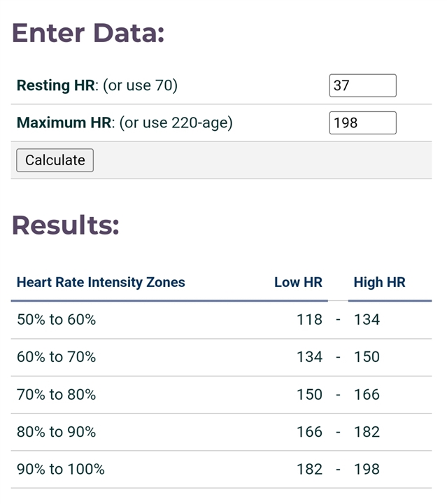

  • Ok, you are right, now do you know how I can do or what information to enter so that the areas are like this manually? since it doesn't let me edit cads area by BPM Pd:I attached a print (karvonen method)
  • I do not know where the table you posted comes from, but it is definitely wrong. Use the calculator, and you will see that their percentages do not match the absolute values at all. For example 90% of 198 bpm is definitely not 182! It is 178, just as Garmin correctly calculates. So maybe you should simply stop relying on someone who is not even capable to calculate the percentages Stuck out tongue winking eye
  • ... but looking at it again, I see your table is actually not using the Max HR as the basis of the table, It is using the HR Reserve. So just use the same basis on Garmin's side, and you'll be fine.
    For example:
    37 + 90% of (198 - 37) = 182

    well, I found the solution. I had to change the measurement to %FCR and adjust a couple of maximum points only (FCRMAX). I also had to reset the zones (50/59-60/69, etc.) and then it worked perfectly for the Karvonen example that I sent you. Thank you very much for your time anyway.
