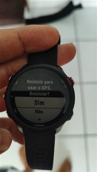

Meu GPS não está funcionando no meu fr 245 music. Sempre pede para atualizar o GPS e nunca funciona. Fiz todos os passos que o suporte passou e segue com o mesmo problema. O que devo fazer?
It always asks to update the GPS and it never works.
Could you write what exactly it tells?
I did all the steps that support went through and still have the same problem.
What were those steps? (to avoid repeating the same advices here)
If deleting the EPO or CPE file from //GARMIN/RemoteSW + syncing with Garmin Express, and also the master reset to factory defaults with deleting all data did not help, then in your place I would contact the Support again and request a replacement device.
